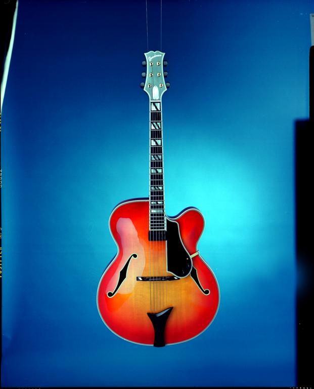

Here's a cherry sunburst I built a while ago.

Brad,
Spectacular! I love that burst.
How wide is that beauty at the lower bout?
Can we see the back?
Jeff

Wow... sweet archtop. I like your headstock too....

Brad
You make some very sweet guitars.

Brad you da man! Beautiful guitar. I love the burst.

Whoa! What a fine guitar and the burst is incredible! I really respect a well done burst. So often the transitions are to bold and not flowing, Brad, your burst look like at tequila sunrise! With the grenadine slowly and softly flowing to the bottom of the glass!

That is VERY tastefully done. The burst, the tailpiece, the headstock shape, the whole enchelida (to continue Lance's metaphore) is just graceful and artistically done

Great job Brad, love the burst. I am going to try one on my next build.

Beautiful burst Brad. What finish are you spraying?>

Brad--Very, very nice!
What kind of wood is the top? Looks like some spectacular figure even showing thru the burst.

Thanks, Guys,
Jeff Doty- The lower bout measures 18". Even though the 18" is not the most "saleable" model it is my favorite to build. I don't think I have a shot of the back of this one,but I think I have another cherry 'burst.
Jeff Brazilwood- I have used this headstock design for 12 years, it actually is based(not copied) on a Stromberg
design, not Gibson.
Tim-It is nitro,which is the only finish I've ever used,I have had a love-hate relationship with it over the years,but at this point I think I love it more than hate it!
npalen-The top is a very silky piece of Sitka spruce that I bought from Gilmer wood.
Jimmie-good luck on your first burst,a few words of caution:
Wath out for drips!! I can't tell you how many times that (literally) one drip from the gun forced me strip all the color coats off and start again!!
Build the color slowly.
Tape the binding with automotive pinstripe tape as carefully as you can.(thank you Bob Bennedetto)
Try not to get the lacquer too thick at the binding edge so you don't get a ridge there
